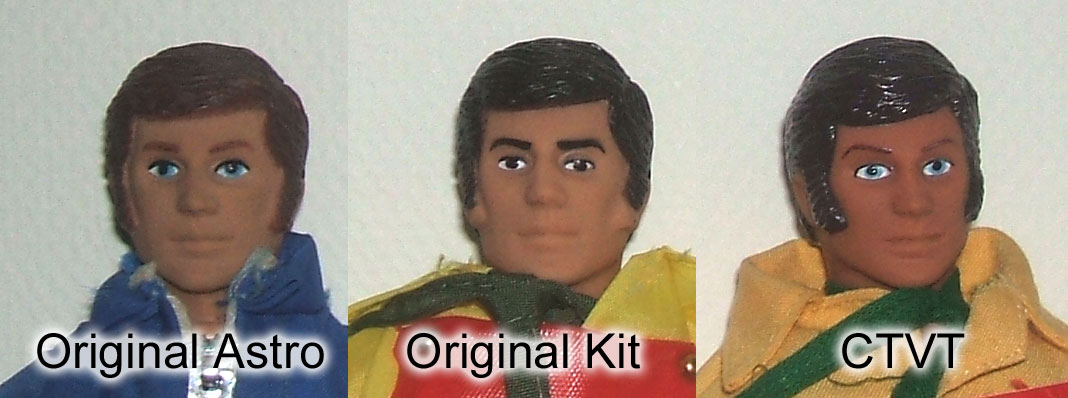

head
The Astronaut's head was also used for Kit Willer from the Tex Willer line. The paintjob on Kit is a little different. Kit has darker brown hair, shorter sideburns, and black eyes. The Astronaut has lighter brown hair and blue eyes. CTVT reproduced the head for their Willer line, but used the longer painted sideburns and blue eyes of the Astronaut, but the darker brown hair of Kit Willer. The reproduction is unmarked.
