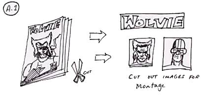

One standby I love for making boxes is to first get my hands on
several images of the character, such as old comics. This gets me to thinking
about the design of the box, the color scheme, and also gives me some
Lettering to use as the character's name sign on the box.

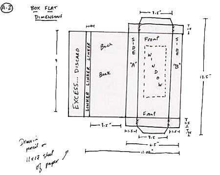

The first thing you need to do to make a box is design a layout
for the box, called a Flat. This is a pencil design of the
dimensions of the unfolded box which you will design as a montage of images
to adorn your box. Begin with a sheet of 11x17 paper and draw the pattern
seen in (fig. A.2) with the exact dimensions seen there.

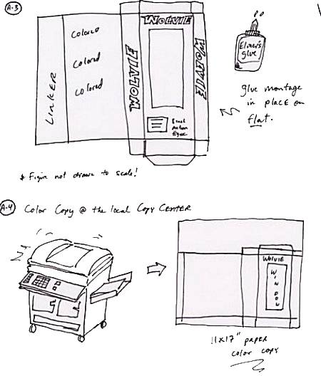

Now start to paste your lettering and pictures into place on your
box. Remember to leave the area of the window blank (if you have one).
I tend to have the dimensions of my window be 2.5x6" and begin about 1"
below to the top edge. I start by laying down sheets of construction paper
in the base color I want, i.e. for my Flash box, I laid down pieces of
red construction paper and pasted them in place. Then I glued the lettering
on separately. Go wild with this! Don't let your imagination be constrained
simply by what Mego did.
Try thinking of a name for your toy line, and a logo.... Charlee
Flatt used to call his the "Unofficial World's Greatest Super Heroes."
I call mine "The Unsung Heroes Collection," as I frequently make characters
whom I feel have not gotten adequate figure representation, and I call
my villains "The Unsavory Villains Collection," since you can't really
say, unsung villains now, can you?
Anyway, what can you come up with? Once you have glued in all of
your box design articles (fig. A.3), take your box flat to your local

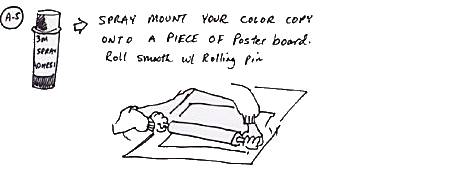

copy center and get a 11x17 color copy made of it (fig. A.4). Using Spray
Mount by 3M, mount your color copy onto a posterboard and cut out along
the box lines (fig. A.5). Fold your box into shape but don't glue anything
yet!

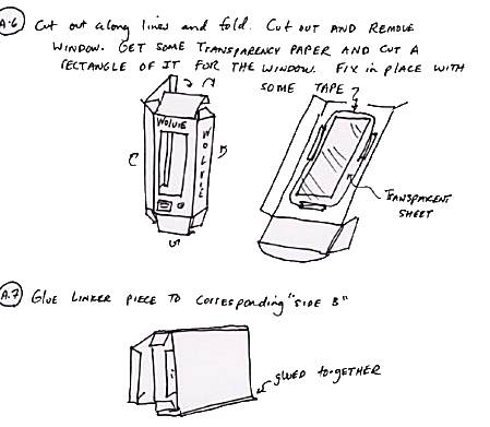

Cut
out the window of the box using an X-Acto knife, and tape in a window
made of some Transparency paper (fig. A.6). Fold the box into shape and
glue it closed using Elmer's glue at the place where the "linker" section
of the box, and box "side B" overlap, the "linker" goes on the inside
(fig. A.7). Your box is now done!

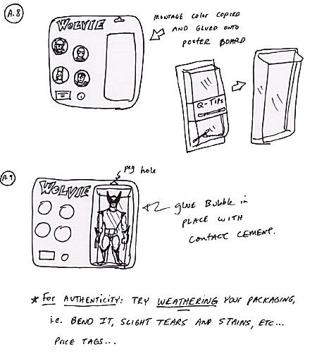

But what's that I hear you say? "Matt.... what we really wanted
in the way of packaging was a CARD." No problem...
This is actually a lot easier to make than a box. Simply design
a flat in much the same way you would a box, but in the dimensions of
the desired card packaging. make color copy and mount it onto posterboard
as before. But now.... you need a bubble large enough for the figure to
fit in. Well unless you have a real Mego card to cannibalize, you're outta
luck. But wait! Don't despair yet! Can you think of any product you see
I the drug store everyday that has a bubble similar in size and shape
to a Mego figure bubble...
Give up? Q-TIPS! I know... it seems unlikely, but I stumbled onto
this idea one day at a flea market when, from a distance, a bunch of Q-tip
boxes stacked on top of each other seemed like a bunch of action figures.
I bought one, took it home, and sure enough, it was large enough to accommodate
a Mego. However, you must make sure that the bubble is large enough--
many brands aren't. The kind I get are not actual Q-Tip brand (by Johnson
and Johnson) rather a generic one I get at the everything's a buck store.
Embarrassing as it may be, you might have to sneak a Mego into the store
and hold it up against the bubble to see if it will fit (fig. A.8)
So anyway, get your cotton swab box bubble, remove it from it's
backing, store the swabs in a Zip-Lock baggy in the medicine drawer, and
use some goof off to get the paper residue off the edges of the bubble.
Now glue that sucker in place onto the card with the figure inside (fig.
A.9).

2) If you want to get that authenticity factor and really fool your
friends, try intentionally weathering your custom packaging. In
other words, crease the card a bit, tear the card board slightly, stain
it with a few drops of coffee or dirty water, put a slight tear in the
window. Place price tags on them. Most clerks at K.B. will be good about
giving you some stickers for your very own. See my custom Flash and Spectre
