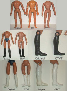

Type 2 Body
type2bodies
This line was only available on the second version of the male body, which was more buff and had plastic joints instead of metal rivets, and strung together with hooks and rubber. Both Doctor Mego and Classic TV Toys offer factory made repro Mego bodies. DM's (marked 7th Street Toys on the back) is very accurate in detail and appearance. Lighter in flesh color, with a heavier feel and more rubbery hands. CTVT's bodies (marked Figures, Inc. on the back) are closer to original color, but tend to run a touch shorter, are more fragile, and have a slightly different design. A telltale sign of the CTVT body are the legs that tend to snap together at the knees. It should also be noted that Tim Mee produced the Type 2 body during the Mego era. This is a vintage knockoff that is identical in almost every way to the original body. It's weight is perhaps a touch lighter, and the Mego copyright info on the back of the body has been blotted out, but otherwise it's identical.
Dobey and Huggy Bear were on African American bodies and both DM and CTVT have made repro's of this color. The color differences for this body are the same as the caucasion body, and the other differences are the same as well. One point of interest is the hands on the Mego African American bodies in this line. Up until this point, Mego had used the same hairy handed bodies for other darker skinned characters that they used for the Planet of the Apes soldier and general figures. This was corrected for Huggy Bear and Captain Dobey. They have the standard Mego T2 hands in the appropriate color.
The U.K. Palitoy release of these figures often feature the Trek Leg body and examples have been found packaged of the characters with the white Space 1999 version of the boot leg body. For that reason those bodies are listed here, but most commonly the characters are on the standard type 2 body.
